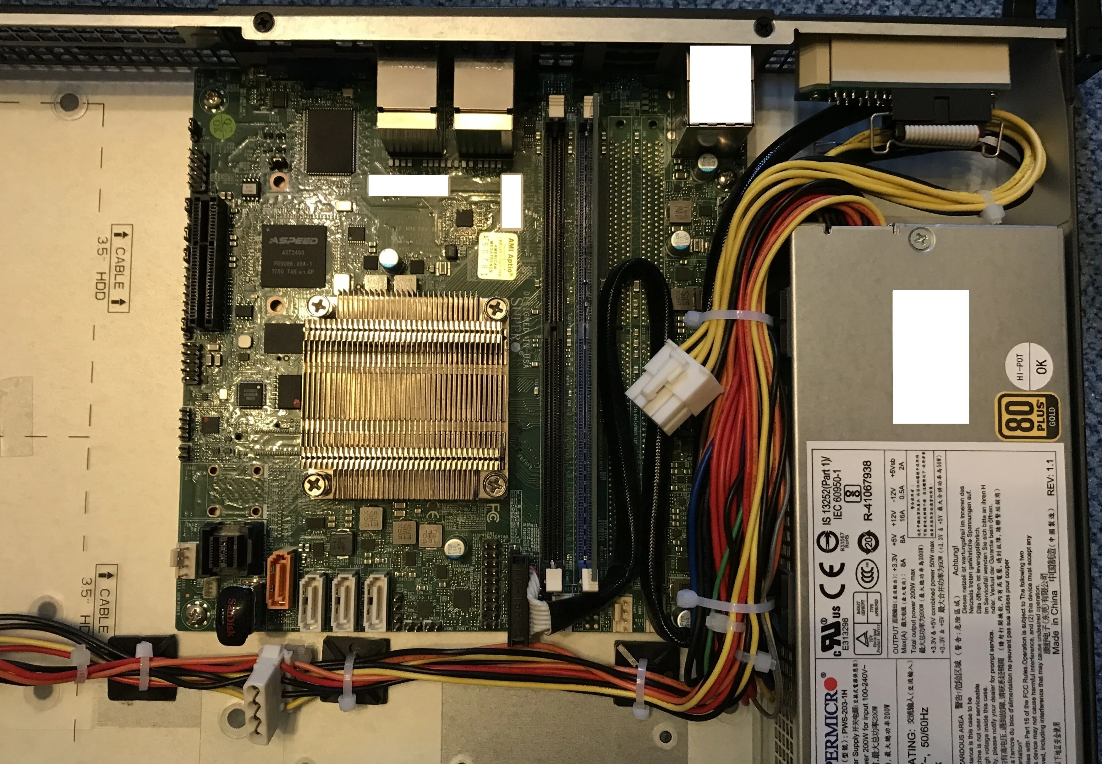

Supermicro A2SDi (Atom C3000)

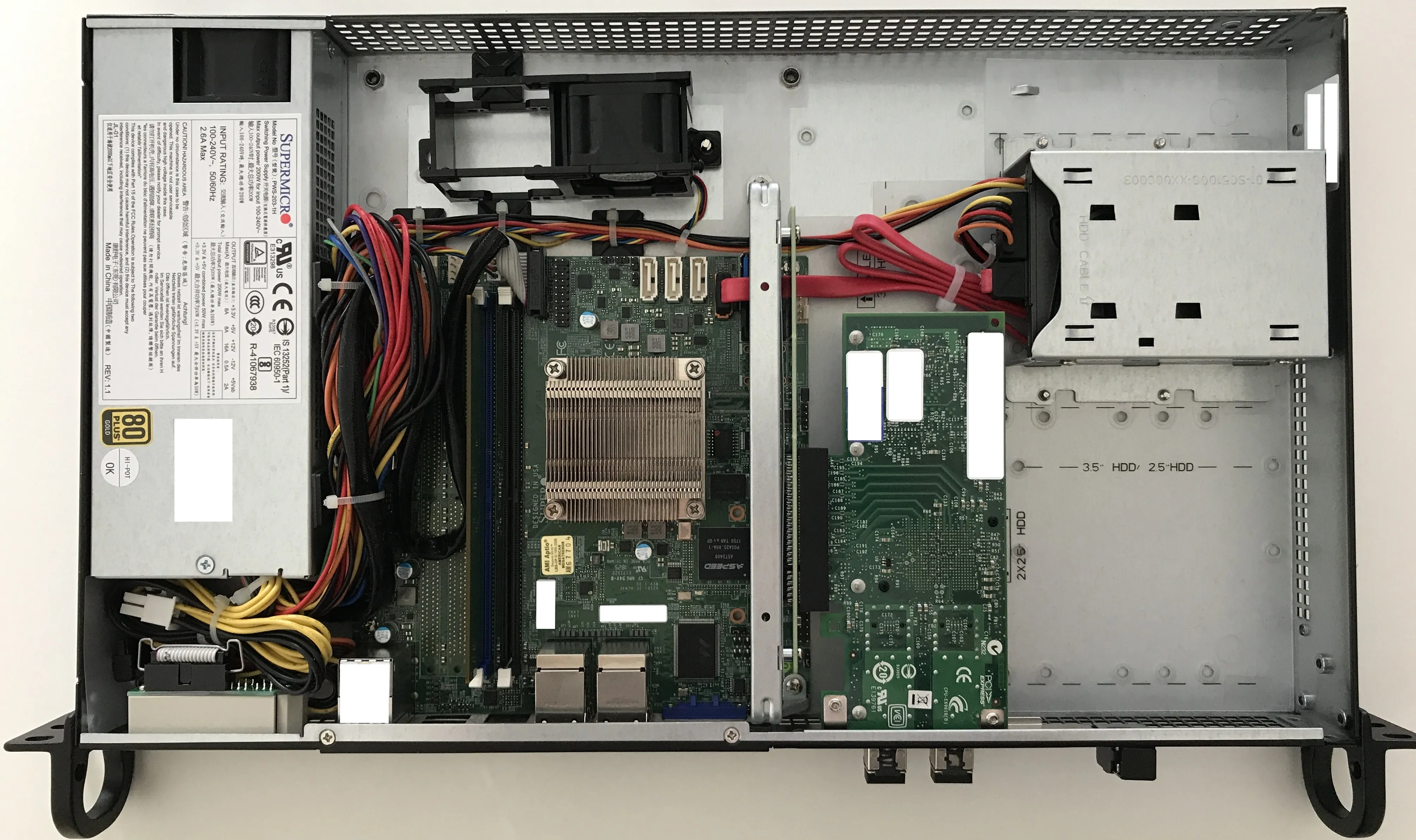

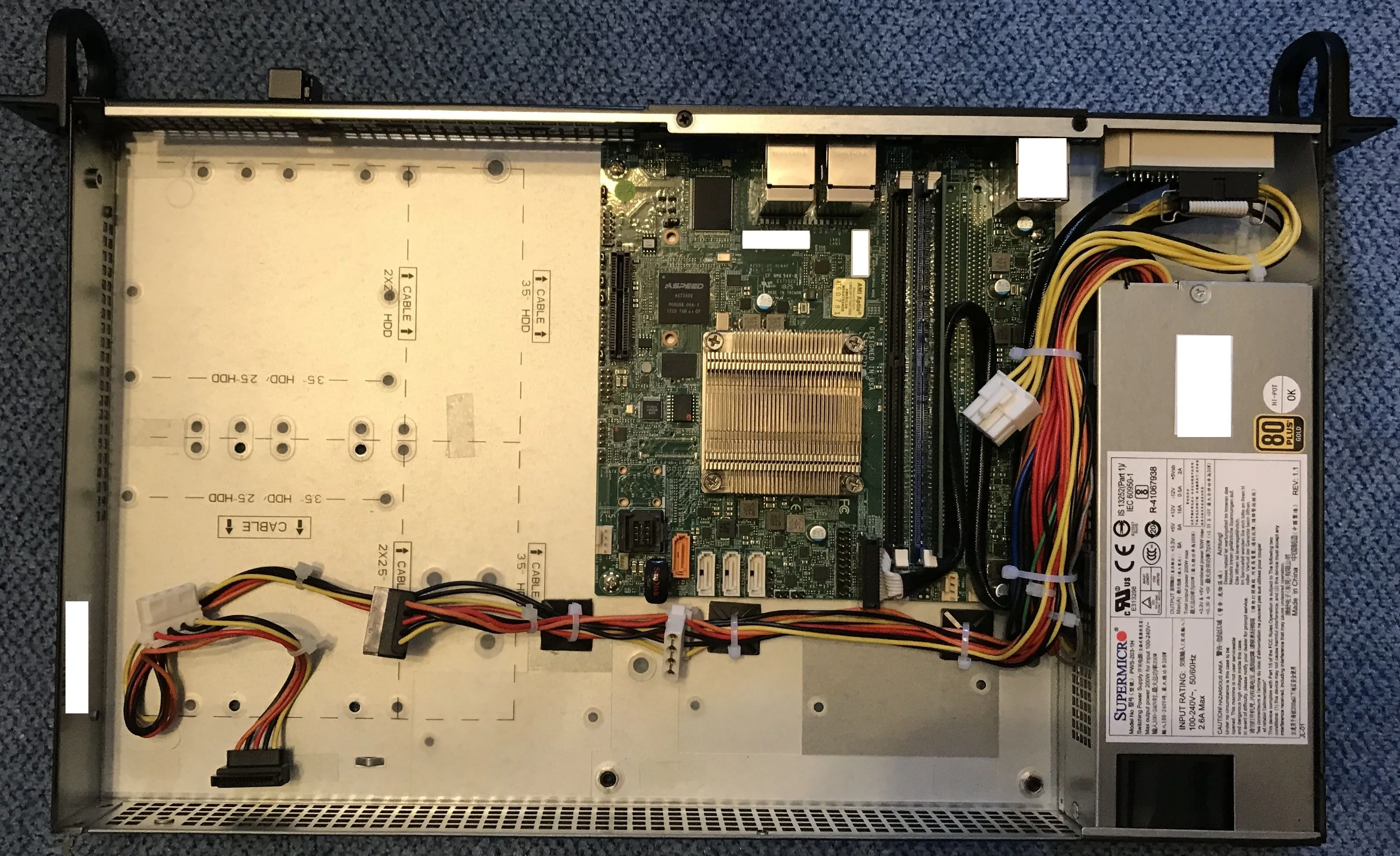

I opted to get one of the new Intel Atom C3000 CPUs to spawn VyOS on it. Running VyOS on an UEFI only device is supported as of VyOS release 1.2.
Supermicro Shopping Cart
  • 1x Supermicro CSE-505-203B (19” 1U chassis, inkl. 200W PSU)
  • 1x Supermicro MCP-260-00085-0B (I/O Shield for A2SDi-2C-HLN4F)
  • 1x Supermicro A2SDi-2C-HLN4F (Intel Atom C3338, 2C/2T, 4MB cache, Quad LAN with Intel C3000 SoC 1GbE)
  • 1x Crucial CT4G4DFS824A (4GB DDR4 RAM 2400 MT/s, PC4-19200)
  • 1x SanDisk Ultra Fit 32GB (USB-A 3.0 SDCZ43-032G-G46 mass storage for OS)
  • 1x Supermicro MCP-320-81302-0B (optional FAN tray)

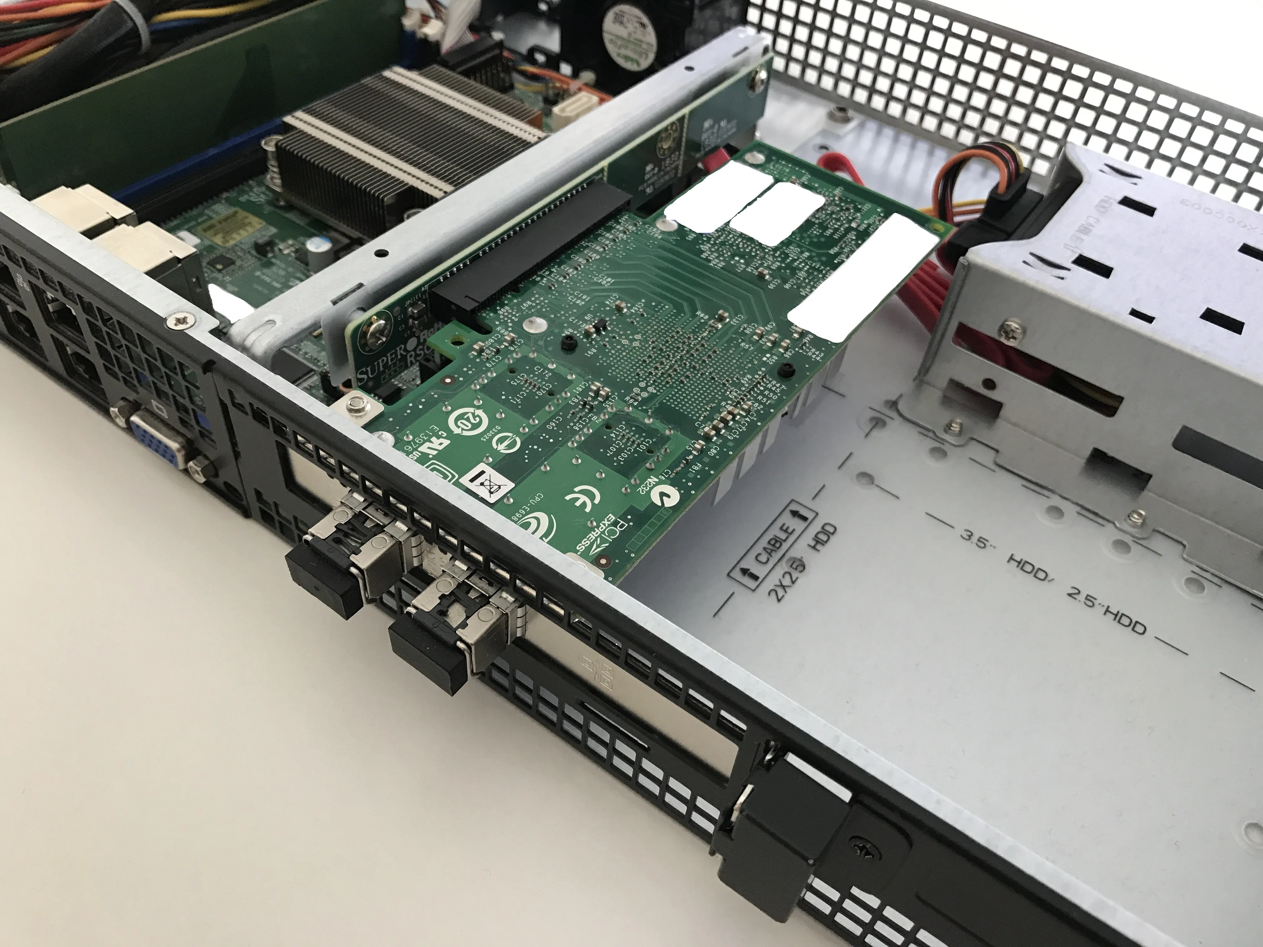

Optional (10GE)
If you want to get additional ethernet ports or even 10GE connectivity the following optional parts will be required:
  • 1x Supermicro RSC-RR1U-E8 (Riser Card)
  • 1x Supermicro MCP-120-00063-0N (Riser Card Bracket)
Latest VyOS rolling releases boot without any problem on this board. You also receive a nice IPMI interface realized with an ASPEED AST2400 BMC (no information about OpenBMC so far on this motherboard).

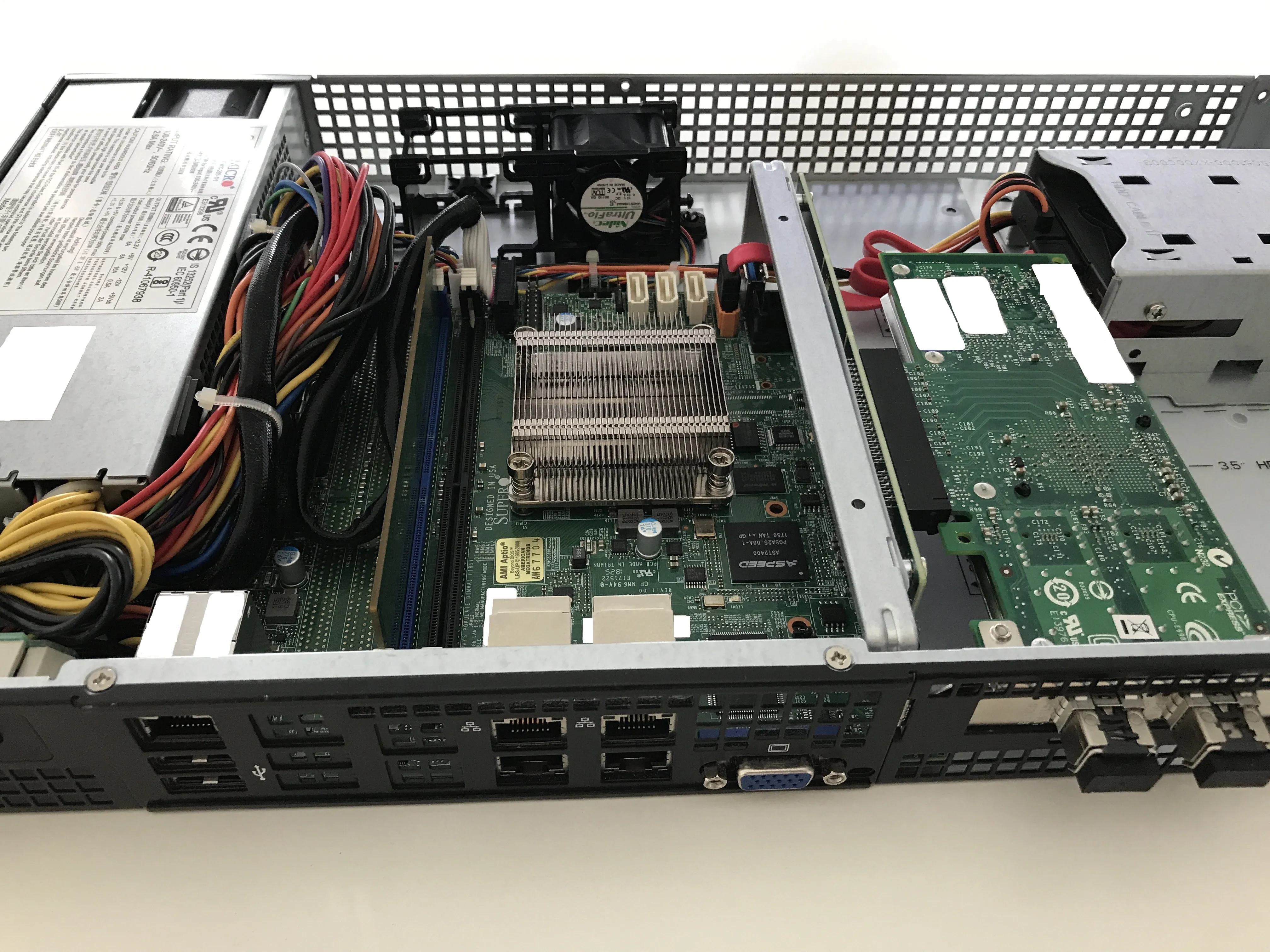

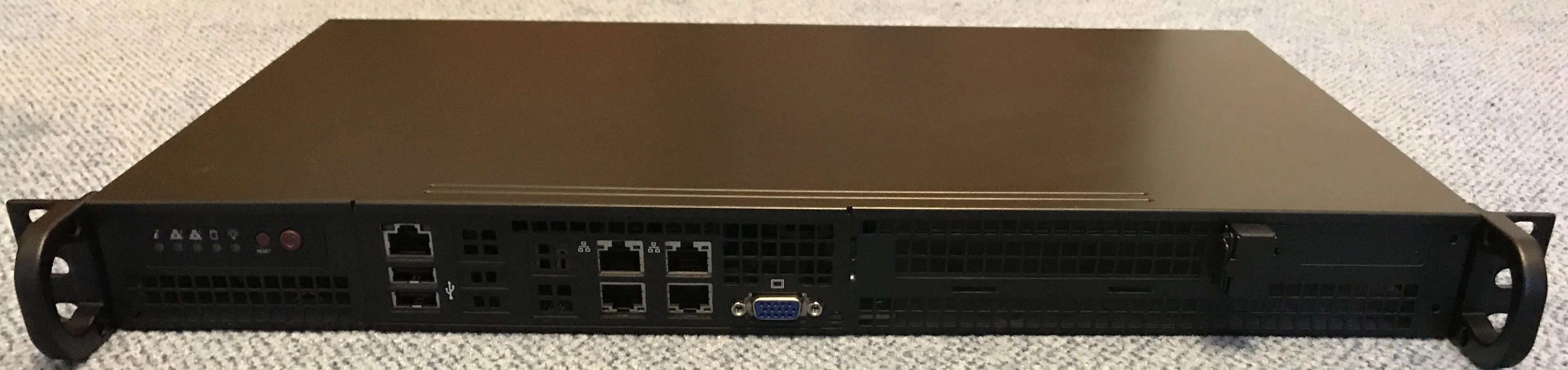

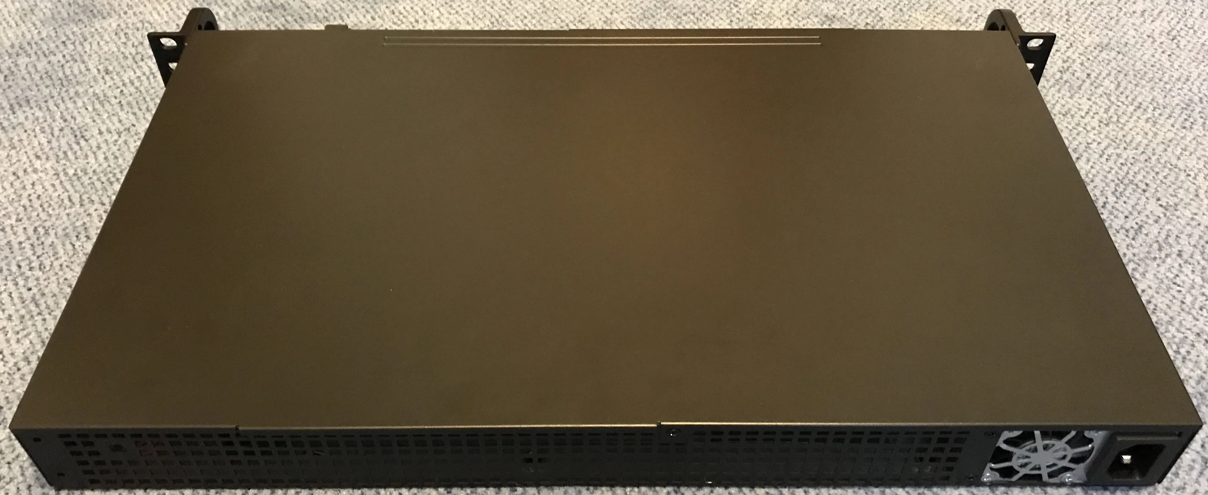

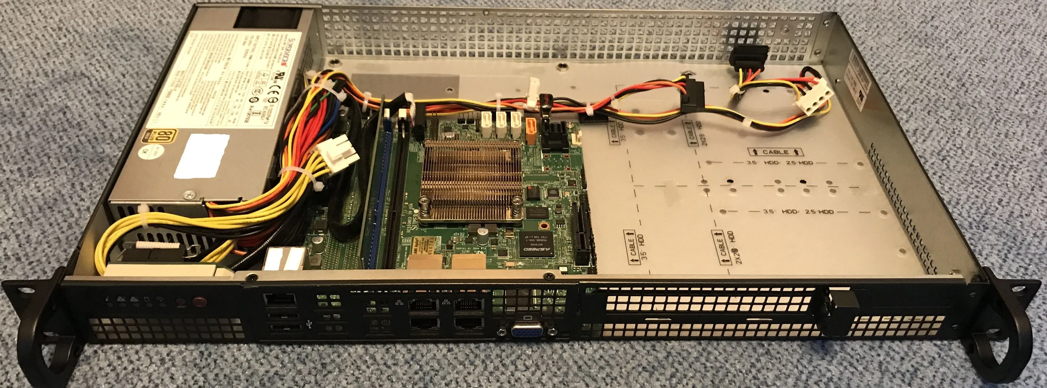

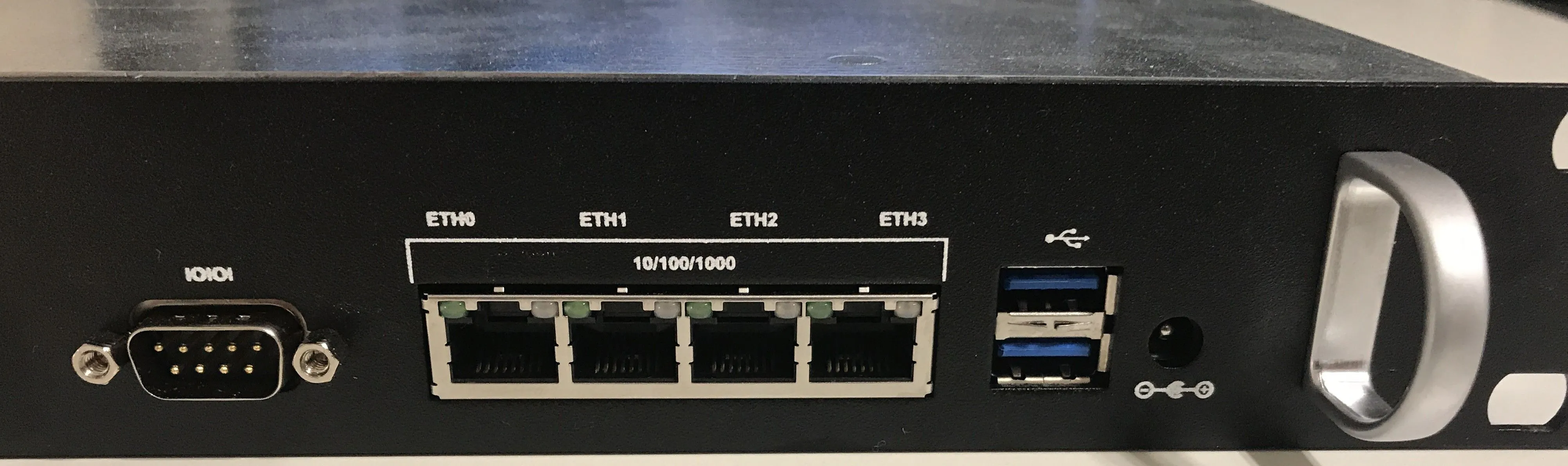

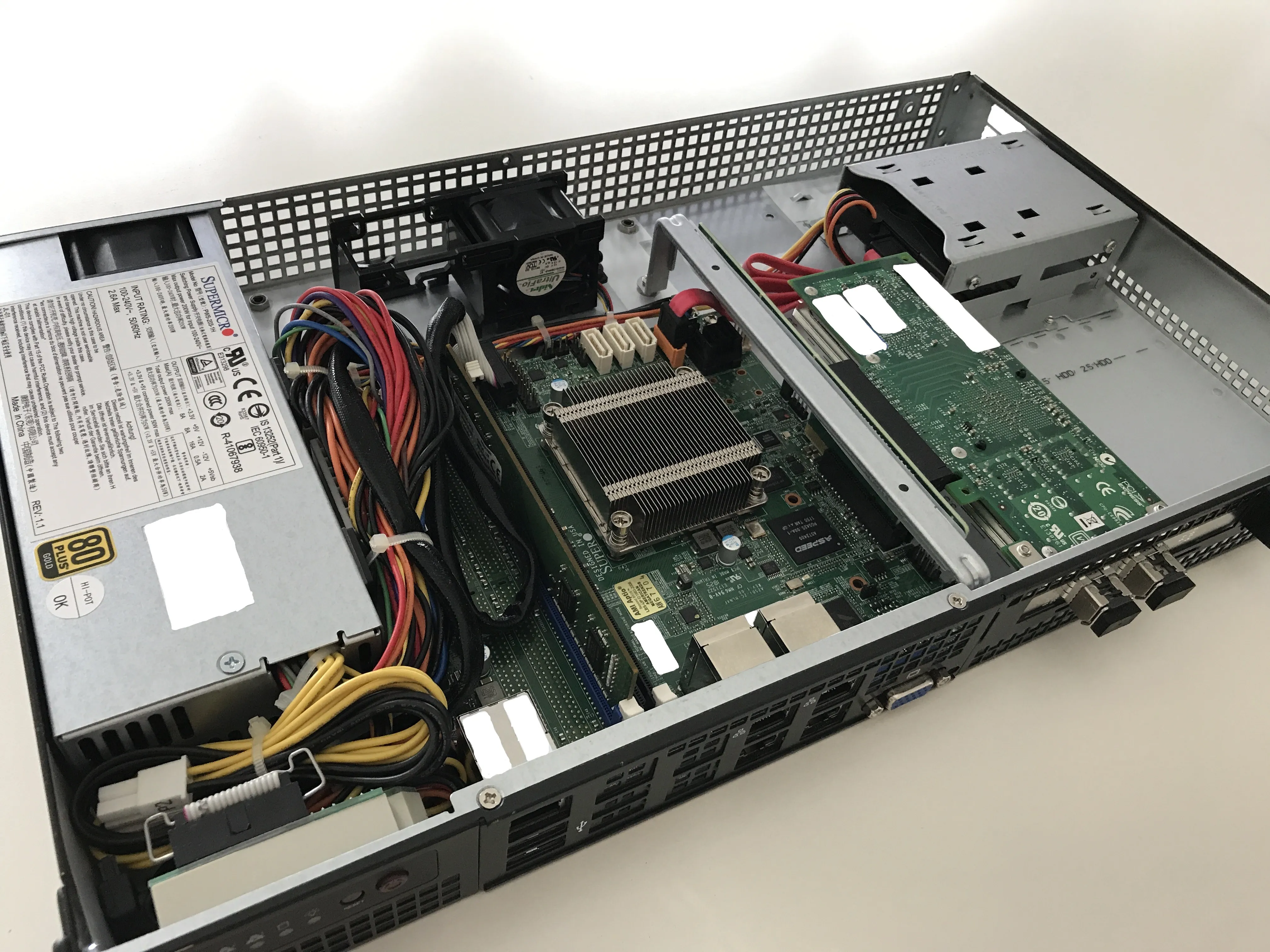

Pictures
CSE-505-203B Back
CSE-505-203B Front
CSE-505-203B Open 1
CSE-505-203B Open 2
CSE-505-203B Open 3
CSE-505-203B w/ 10GE Open 1
CSE-505-203B w/ 10GE Open 2
CSE-505-203B w/ 10GE Open 3

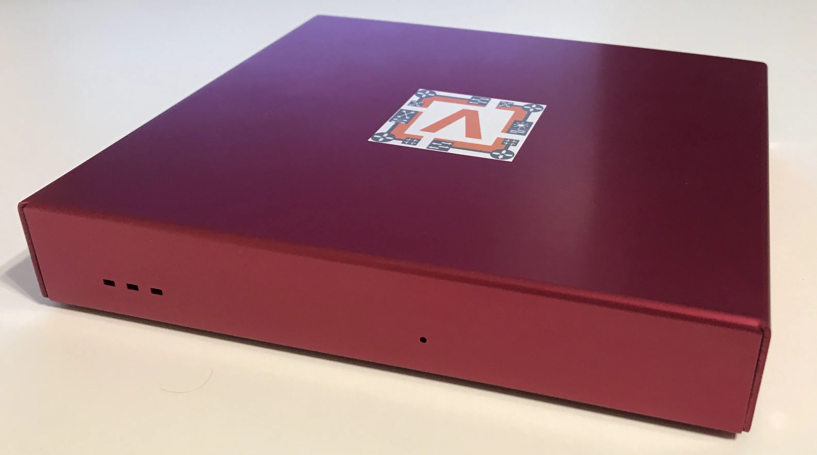

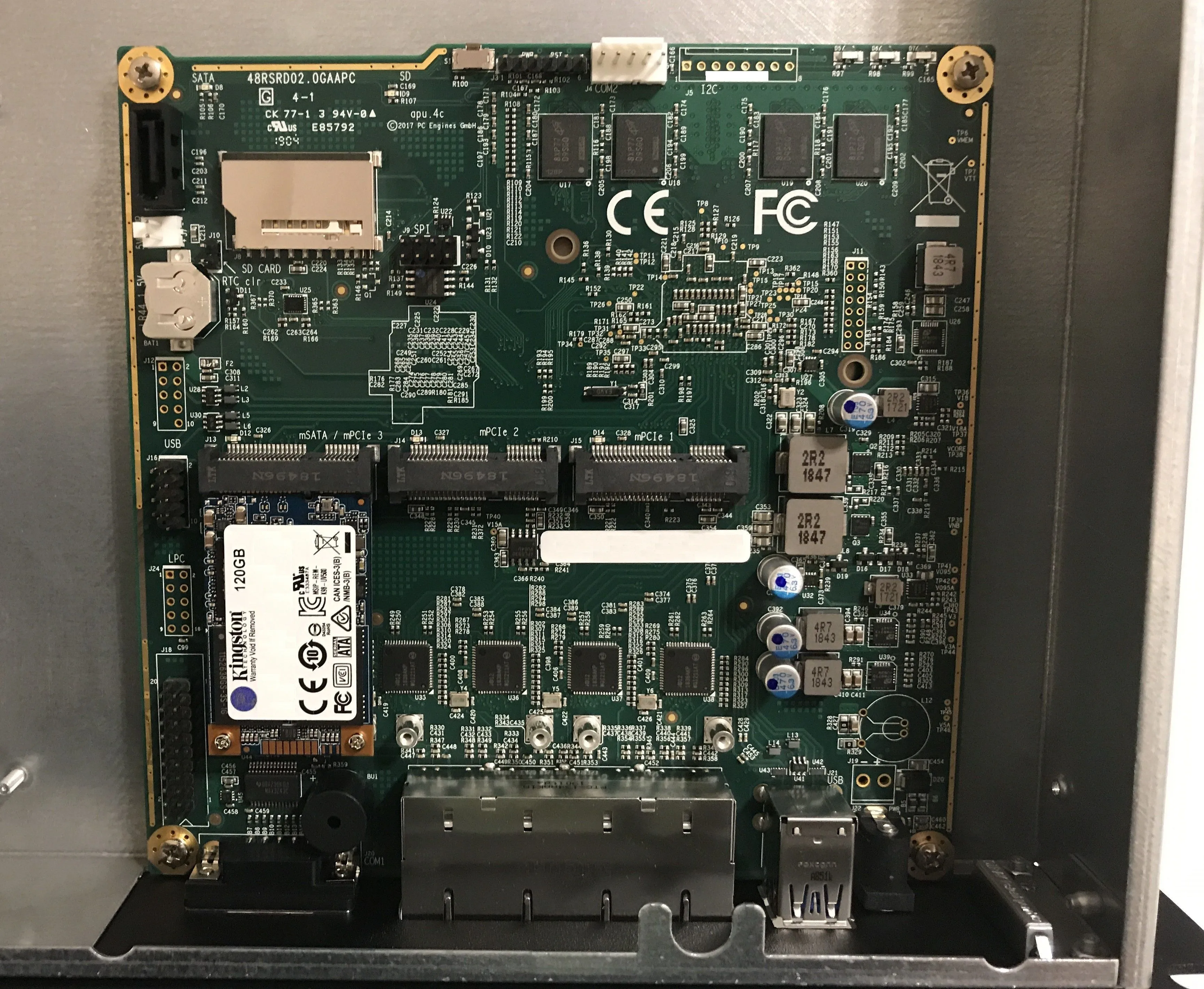

PC Engines APU4
As this platform seems to be quite common in terms of noise, cost, power and performance it makes sense to write a small installation manual.

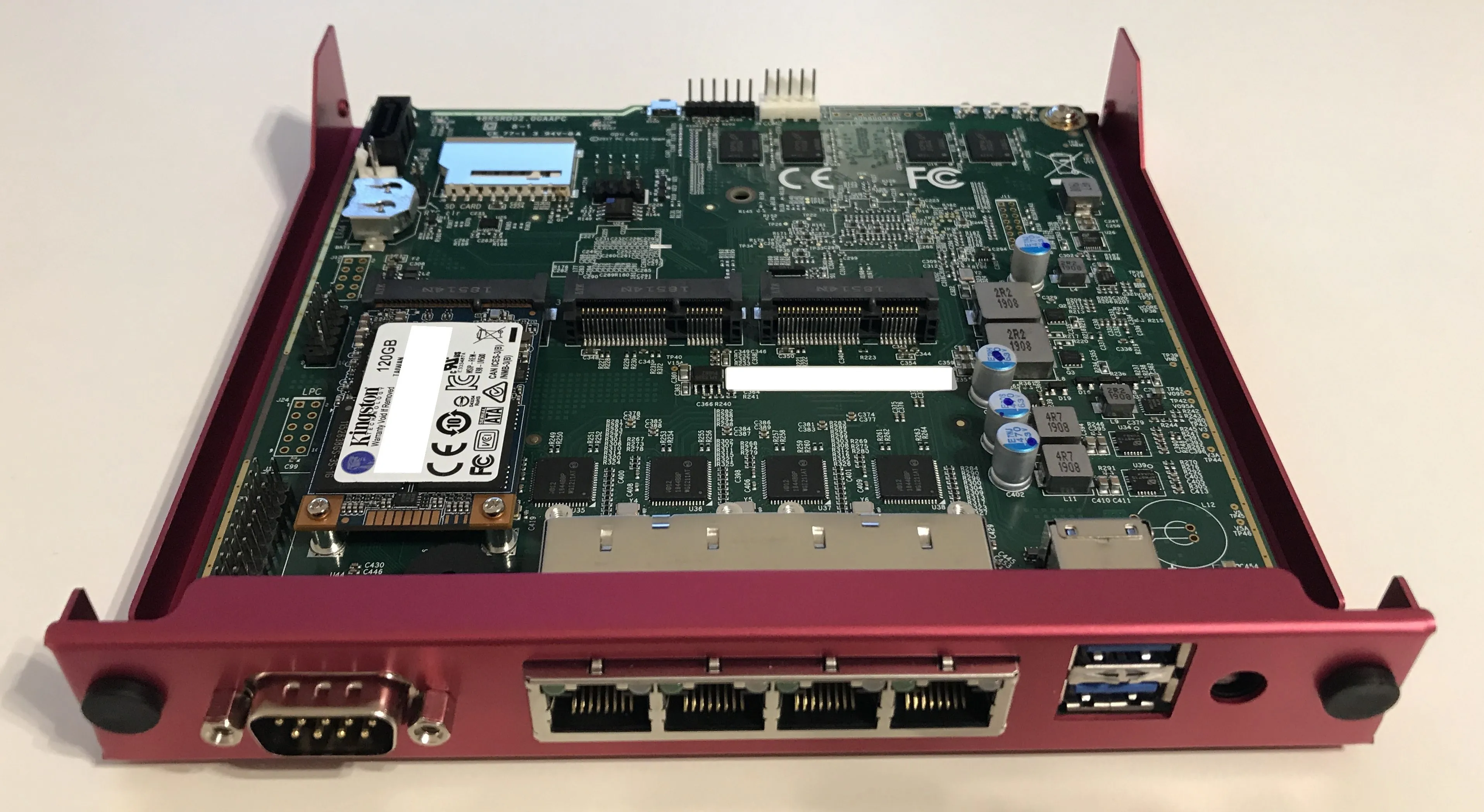

This guide was developed using an APU4C4 board with the following specs:
  • AMD Embedded G series GX-412TC, 1 GHz quad Jaguar core with 64 bit and AES-NI support, 32K data + 32K instruction cache per core, shared 2MB L2 cache.
  • 4 GB DDR3-1333 DRAM, with optional ECC support
  • About 6 to 10W of 12V DC power depending on CPU load
  • 2 miniPCI express (one with SIM socket for 3G modem).
  • 4 Gigabit Ethernet channels using Intel i211AT NICs
The board can be powered via 12V from the front or via a 5V onboard connector.

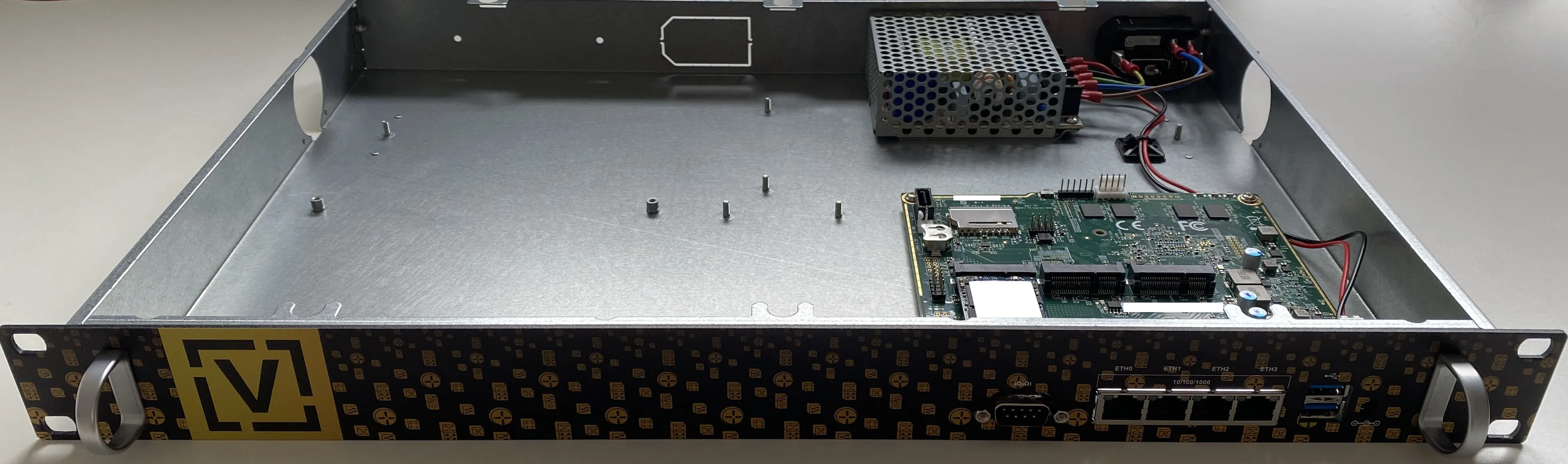

APU4 Shopping Cart
  • 1x apu4c4 = 4 i211AT LAN / AMD GX-412TC CPU / 4 GB DRAM / dual SIM
  • 1x Kingston SUV500MS/120G
  • 1x VARIA Group Item 326745 19” dual rack for APU4
The 19” enclosure can accommodate up to two APU4 boards - there is a single and dual front cover.

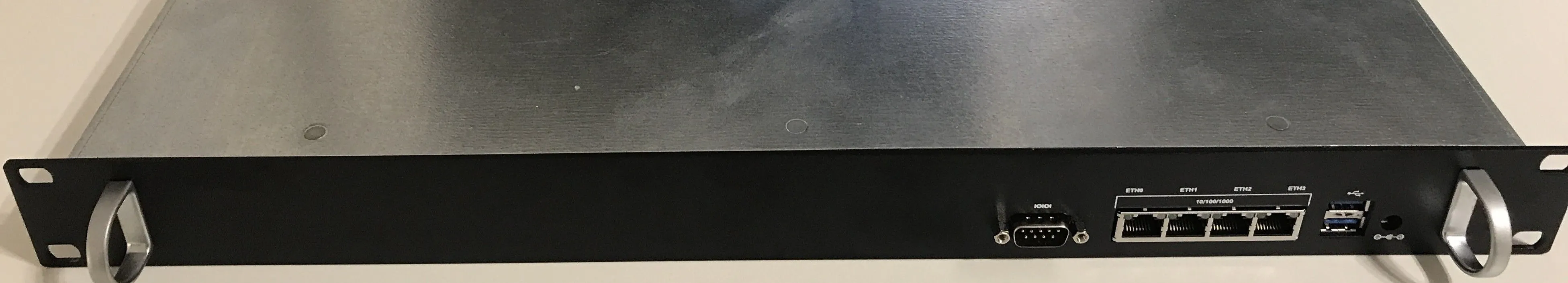

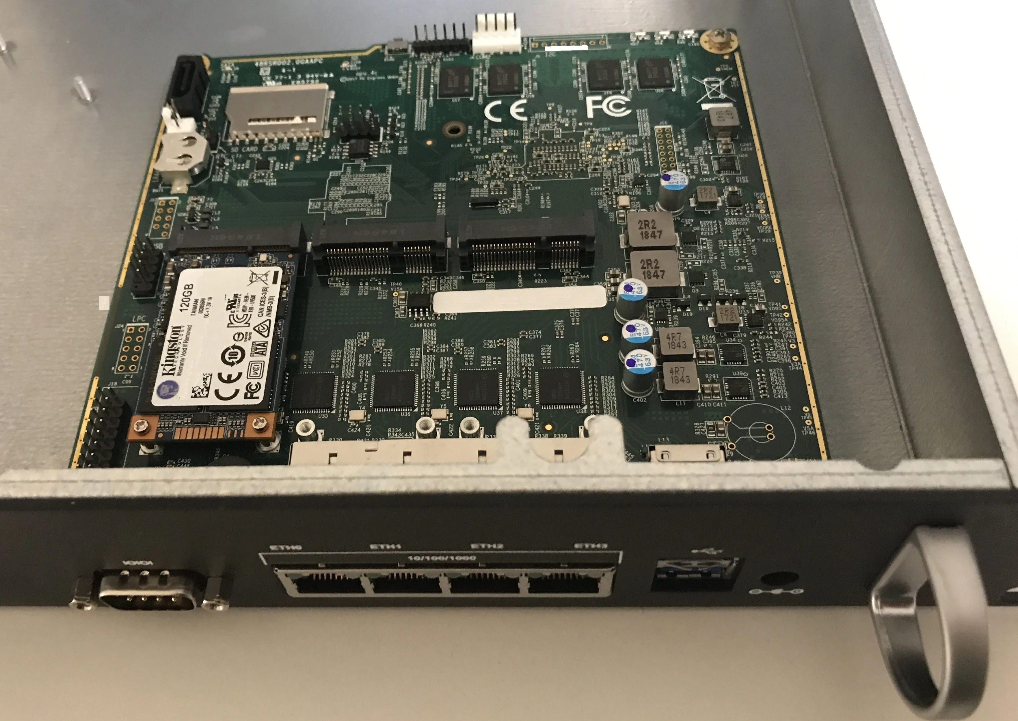

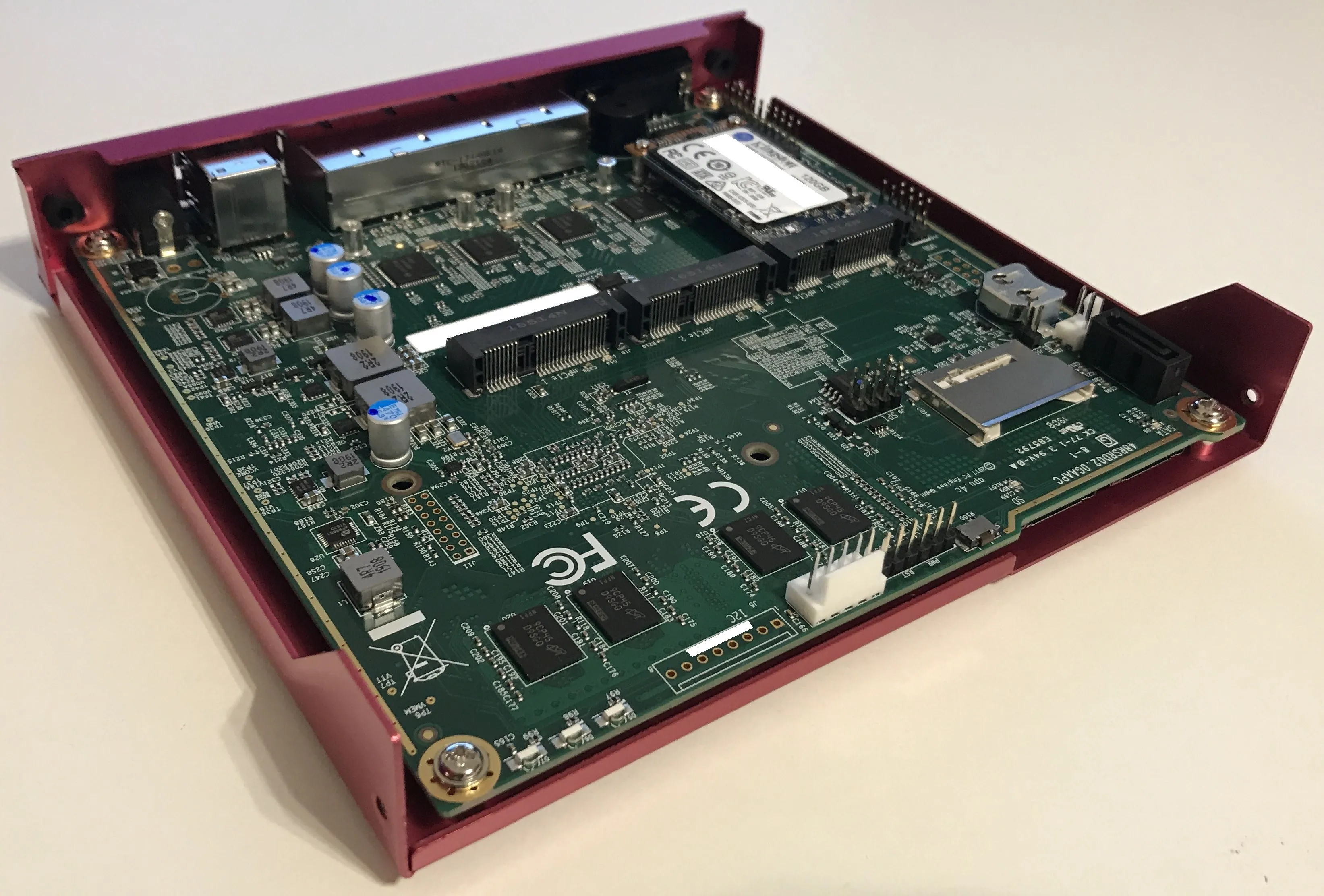

Pictures

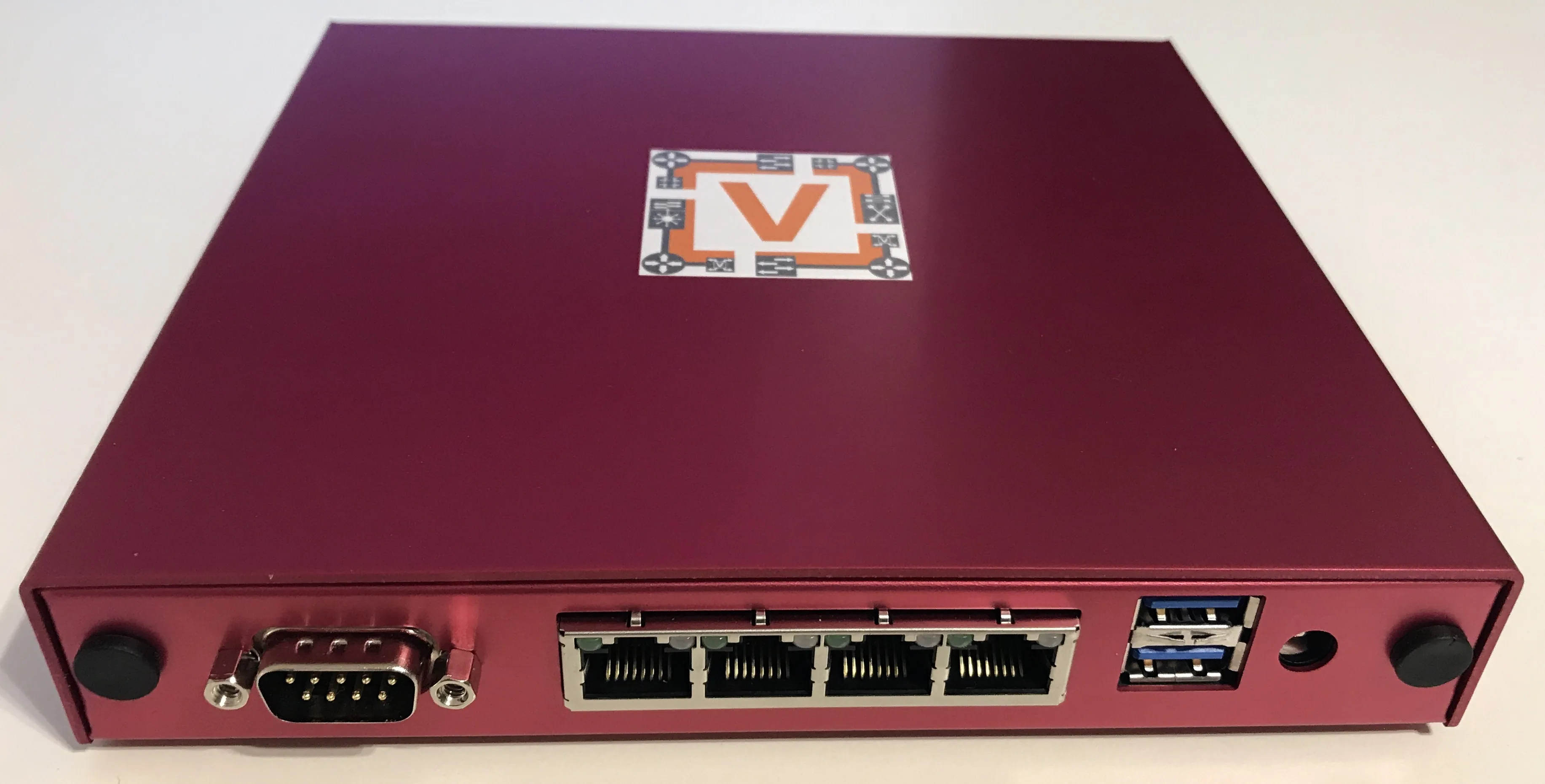

Both device types operate without any moving parts and emit zero noise.

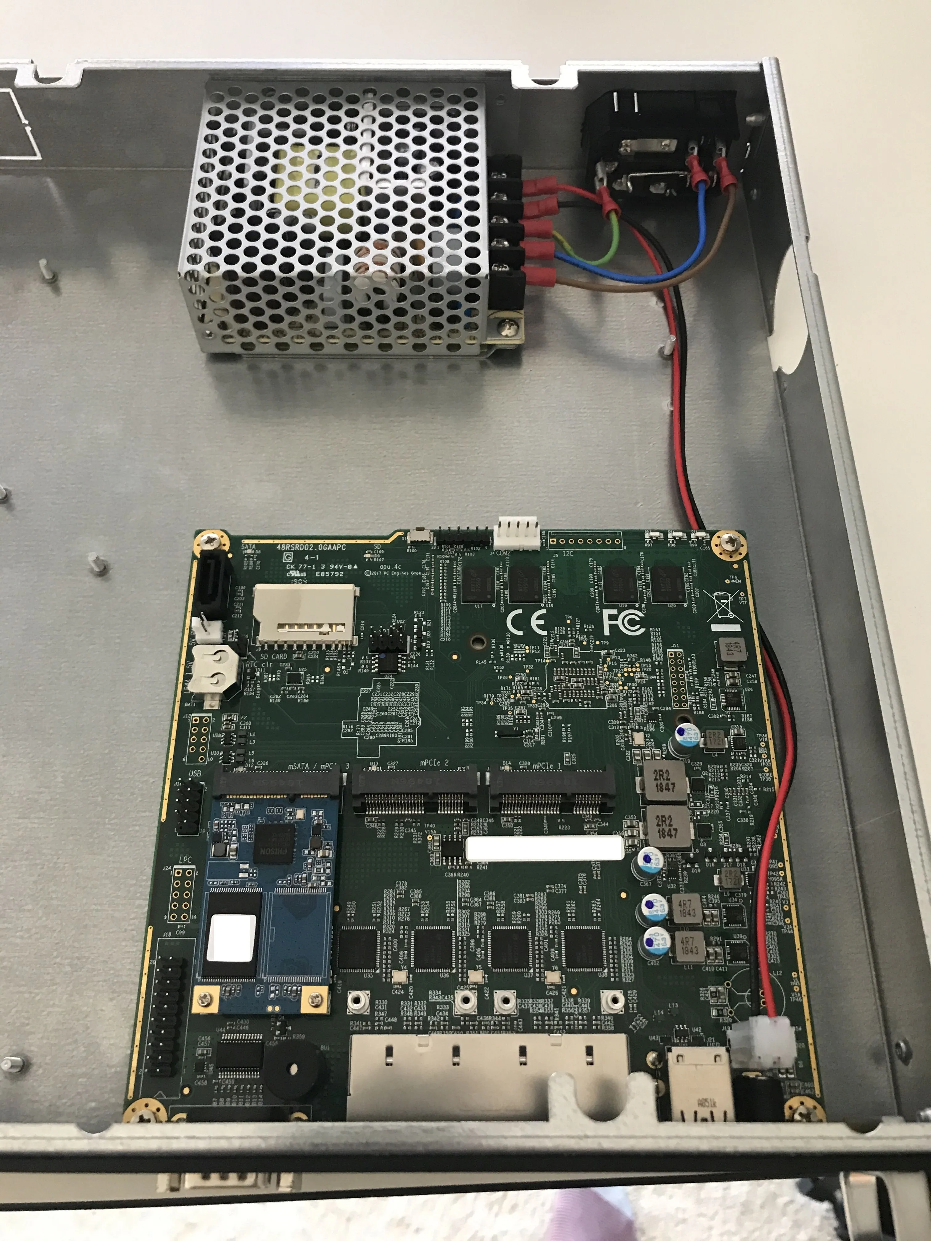

Rack Mount
APU4 rack closed
APU4 rack front
APU4 rack module #1
APU4 rack module #2
APU4 rack module #3 with PSU
VyOS custom print
APU4 custom VyOS powder coat
Desktop / Bench Top
APU4 desktop closed
APU4 desktop closed
APU4 desktop back
APU4 desktop back

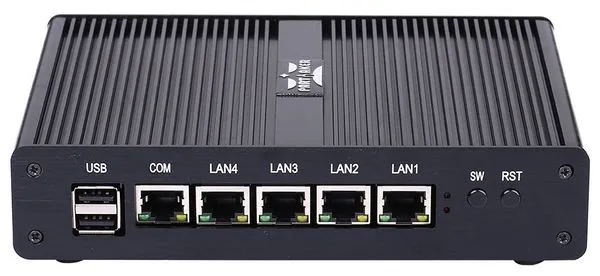

Partaker i5
../_images/600px-Partaker-i5.webp
I believe this is actually the same hardware as the Protectli. I purchased it in June 2018. It came pre-loaded with pfSense.
Manufacturer product page.
Installation
  • Write VyOS ISO to USB drive of some sort
  • Plug in VGA, power, USB keyboard, and USB drive
  • Press “SW” button on the front (this is the power button; I don’t know what “SW” is supposed to mean).
  • Begin rapidly pressing delete on the keyboard. The boot prompt is very quick, but with a few tries you should be able to get into the BIOS.
  • Chipset > South Bridge > USB Configuration: set XHCI to Disabled and USB 2.0 (EHCI) to Enabled. Without doing this, the USB drive won’t boot.
  • Boot to the VyOS installer and install as usual.
Warning the interface labels on my device are backwards; the left-most “LAN4” port is eth0 and the right-most “LAN1” port is eth3.

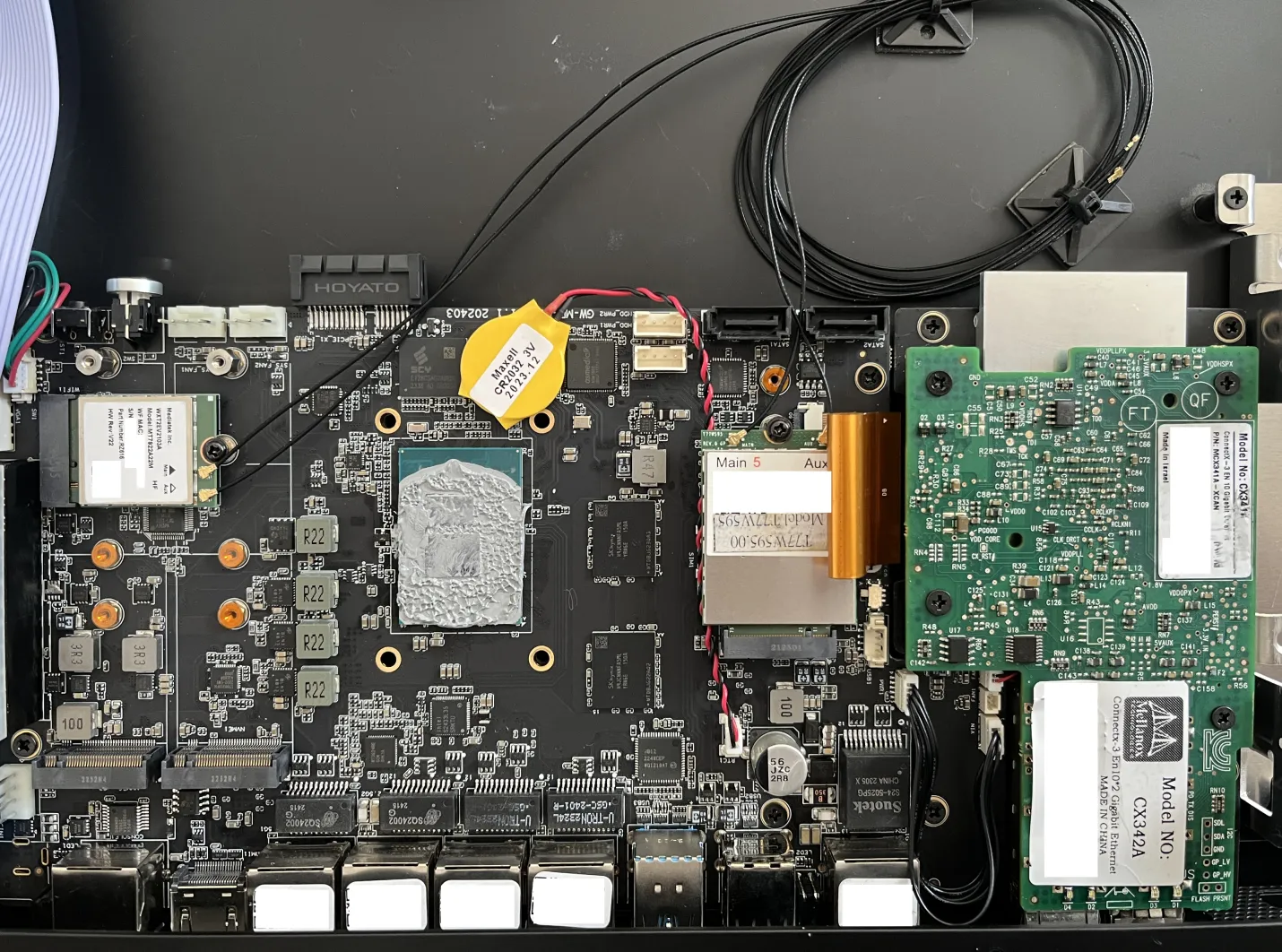

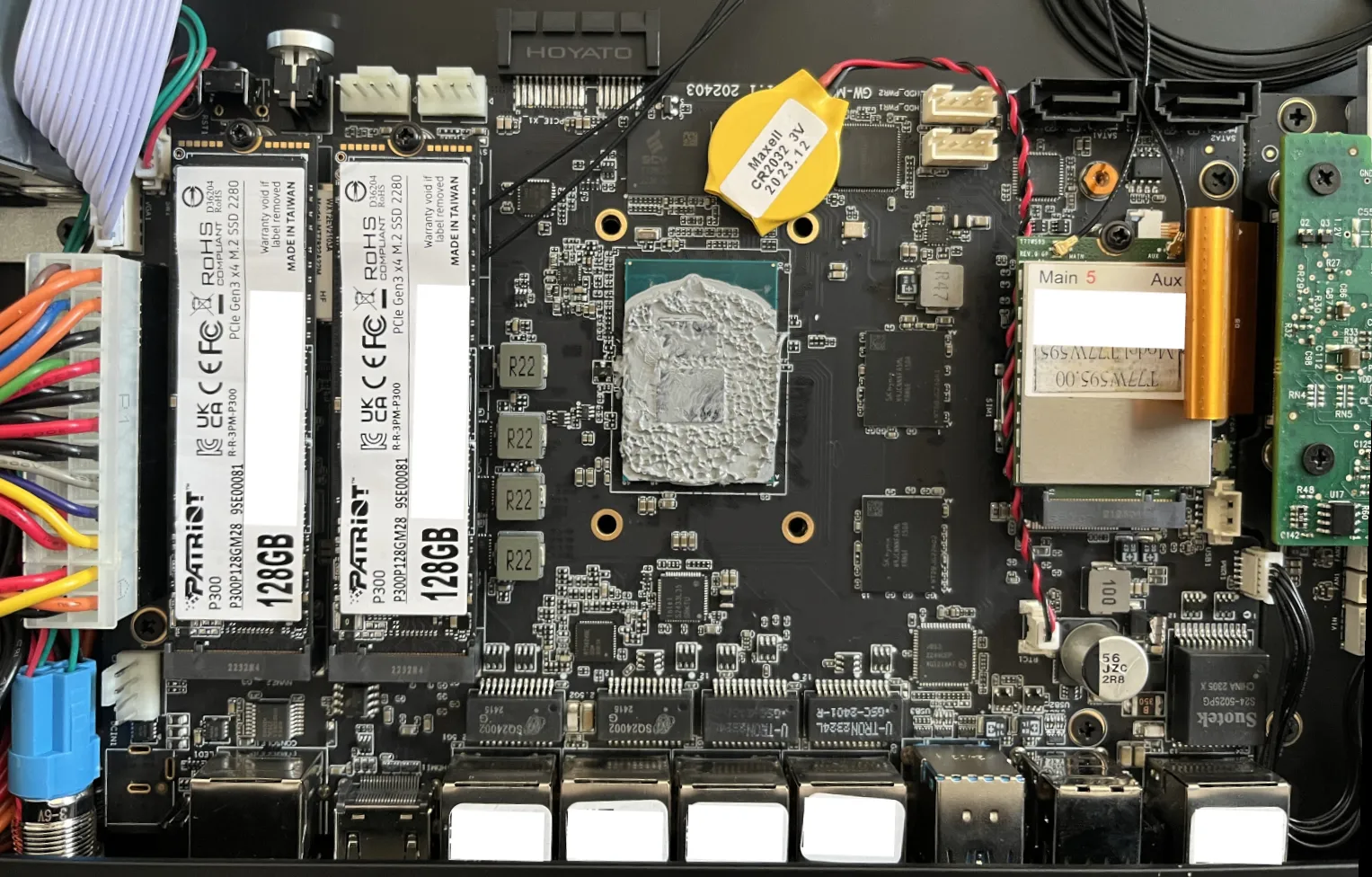

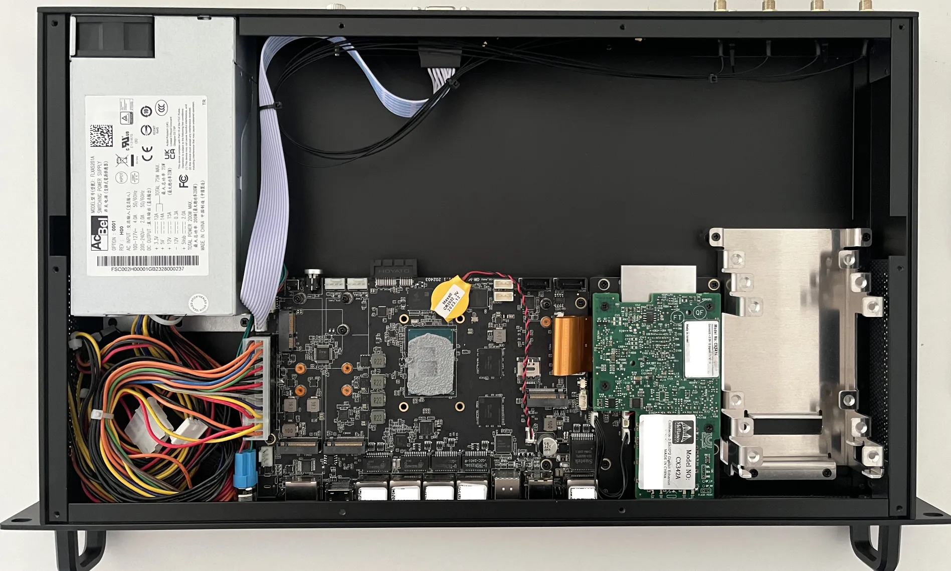

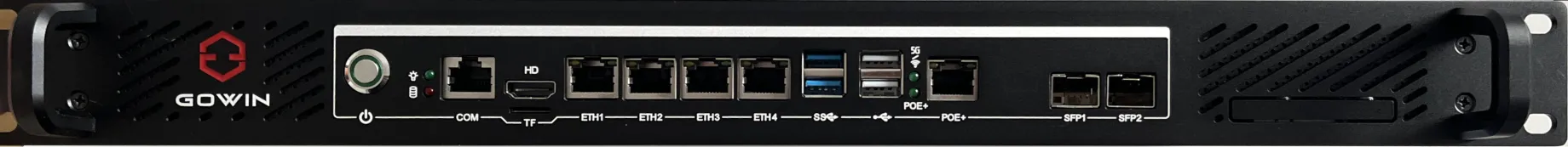

Gowin GW-FN-1UR1-10G
A platform utilizing an Intel Alder Lake-N100 CPU with 6M cache, TDP 6W. Onboard LPDDR5 16GB RAM and 128GB eMMC (can be used for image installation).
The appliance comes with 2 * 2.5GbE Intel I226-V and 3 * 1GbE Intel I210 where one supports IEEE802.3at PoE+ (Typical 30W).
In addition there is a Mellanox ConnectX-3 2* 10GbE SFP+ NIC available.
NOTE: This is the entry level platform. Other derivates exists with i3-N305 CPU and 2x 25GbE!
Gowin Shopping Cart
  • 1x Gowin GW-FN-1UR1-10G
  • 2x 128GB M.2 NVMe SSDs
Optional (WiFi + WWAN)
  • 1x MediaTek 7921E M.2 NGFF WIFI module (not tested as this currently leads to a Kernel crash)
  • 1x HP LT4120 Snapdragon X5 LTE WWAN module
Pictures
../_images/gowin-01.webp
../_images/gowin-02.webp
../_images/gowin-03.webp
../_images/gowin-04.webp
Cooling
The device itself is passivly cooled, whereas the power supply has an active fan. Even if the main processor is powered off, the power supply fan is operating and the entire chassis draws 7.5W. During operation the chassis drew arround 38W.
BIOS Settings
No settings needed to be altered, everything worked out of the box!
Installation
The system provides a regular RS232 console port using 115200,8n1 setting which is sufficient to install VyOS from a USB pendrive.
First Boot
Please note that there is a weirdness on the network interface mapping. The interface <-> MAC mapping is going upwards but the NICs are placed somehow swapped on the mainboard/MACs programmed in a swapped order.
See interface description for more detailed mapping.

      3: /dev/nvme1n1 (119.2 GB)
      4: /dev/nvme0n1 (119.2 GB)
Select first disk: 3
Remaining disks:
      1: /dev/sda     (14.4 GB)
      2: /dev/mmcblk0 (116.5 GB)
      3: /dev/nvme0n1 (119.2 GB)
Select second disk: 3
Installation will delete all data on both drives. Continue? [y/N] y
Searching for data from previous installations
No previous installation found
Creating partitions on /dev/nvme1n1
Creating partition table...
Creating partitions on /dev/nvme0n1
Creating RAID array
Updating initramfs
Creating filesystem on RAID array
The following config files are available for boot:
      1: /opt/vyatta/etc/config/config.boot
      2: /opt/vyatta/etc/config.boot.default
Which file would you like as boot config? (Default: 1)
Creating temporary directories
Mounting new partitions
Creating a configuration file
Copying system image files
Installing GRUB configuration files
Installing GRUB to the drives
Cleaning up
Unmounting target filesystems
Removing temporary files
The image installed successfully; please reboot now.
Hardware
vyos@vyos:~$ lspci
00:00.0 Host bridge: Intel Corporation Device 461c
00:02.0 VGA compatible controller: Intel Corporation Alder Lake-N [UHD Graphics]
00:0a.0 Signal processing controller: Intel Corporation Platform Monitoring Technology (rev 01)
00:0d.0 USB controller: Intel Corporation Device 464e
00:14.0 USB controller: Intel Corporation Device 54ed
00:14.2 RAM memory: Intel Corporation Device 54ef
00:15.0 Serial bus controller: Intel Corporation Device 54e8
00:16.0 Communication controller: Intel Corporation Device 54e0
00:1a.0 SD Host controller: Intel Corporation Device 54c4
00:1c.0 PCI bridge: Intel Corporation Device 54b8
00:1c.2 PCI bridge: Intel Corporation Device 54ba
00:1c.3 PCI bridge: Intel Corporation Device 54bb
00:1c.6 PCI bridge: Intel Corporation Device 54be
00:1d.0 PCI bridge: Intel Corporation Device 54b0
00:1f.0 ISA bridge: Intel Corporation Device 5481
00:1f.4 SMBus: Intel Corporation Device 54a3
00:1f.5 Serial bus controller: Intel Corporation Device 54a4
01:00.0 PCI bridge: ASMedia Technology Inc. Device 1806 (rev 01)
02:00.0 PCI bridge: ASMedia Technology Inc. Device 1806 (rev 01)
02:02.0 PCI bridge: ASMedia Technology Inc. Device 1806 (rev 01)
02:06.0 PCI bridge: ASMedia Technology Inc. Device 1806 (rev 01)
02:0e.0 PCI bridge: ASMedia Technology Inc. Device 1806 (rev 01)
03:00.0 Ethernet controller: Intel Corporation Ethernet Controller I226-V (rev 04)
04:00.0 Ethernet controller: Intel Corporation Ethernet Controller I226-V (rev 04)
05:00.0 Network controller: MEDIATEK Corp. MT7922 802.11ax PCI Express Wireless Network Adapter
06:00.0 SATA controller: ASMedia Technology Inc. Device 0622 (rev 01)
07:00.0 PCI bridge: ASMedia Technology Inc. Device 1806 (rev 01)
08:00.0 PCI bridge: ASMedia Technology Inc. Device 1806 (rev 01)
08:02.0 PCI bridge: ASMedia Technology Inc. Device 1806 (rev 01)
08:06.0 PCI bridge: ASMedia Technology Inc. Device 1806 (rev 01)
08:0e.0 PCI bridge: ASMedia Technology Inc. Device 1806 (rev 01)
09:00.0 Ethernet controller: Intel Corporation I210 Gigabit Network Connection (rev 03)
0a:00.0 Ethernet controller: Intel Corporation I210 Gigabit Network Connection (rev 03)
0b:00.0 Ethernet controller: Intel Corporation I210 Gigabit Network Connection (rev 03)
0d:00.0 Non-Volatile memory controller: Device 1ed0:2283
0f:00.0 Non-Volatile memory controller: Device 1ed0:2283
11:00.0 Ethernet controller: Mellanox Technologies MT27500 Family [ConnectX-3]
vyos@vyos:~$ lsusb
Bus 004 Device 001: ID 1d6b:0003 Linux Foundation 3.0 root hub
Bus 003 Device 005: ID 0e8d:c616 MediaTek Inc. Wireless_Device
Bus 003 Device 003: ID 413c:2113 Dell Computer Corp. KB216 Wired Keyboard
Bus 003 Device 004: ID 03f0:9d1d HP, Inc HP lt4120 Snapdragon X5 LTE
Bus 003 Device 002: ID 05e3:0610 Genesys Logic, Inc. Hub
Bus 003 Device 001: ID 1d6b:0002 Linux Foundation 2.0 root hub
Bus 002 Device 002: ID 05e3:0620 Genesys Logic, Inc. GL3523 Hub
Bus 002 Device 001: ID 1d6b:0003 Linux Foundation 3.0 root hub
Bus 001 Device 001: ID 1d6b:0002 Linux Foundation 2.0 root hub
