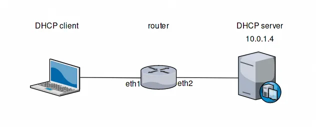

Example
Listen for DHCP requests on interface
eth1.DHCP server is located at IPv4 address 10.0.1.4 on
eth2.Router receives DHCP client requests on
eth1and relays them to the server at 10.0.1.4 oneth2.
DHCP relay example
The generated configuration will look like:

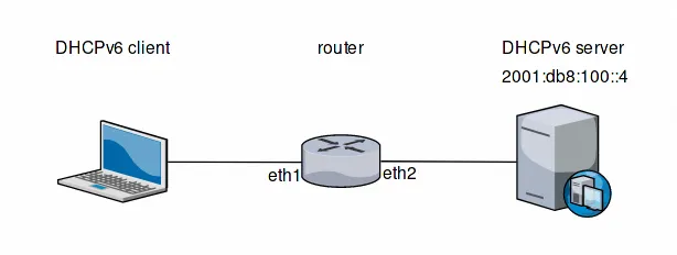

Example
DHCPv6 requests are received by the router on
listening interfaceeth1Requests are forwarded through
eth2as theupstream interfaceExternal DHCPv6 server is at 2001:db8::4
DHCPv6 relay example
