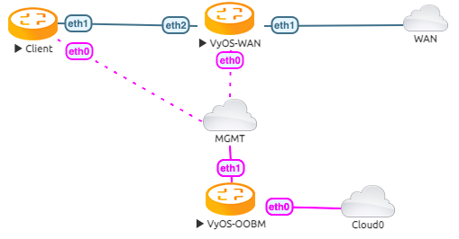

The example topology has 2 VyOS routers. One as The WAN Router and on as a Client, to test a single LAN setup
Tunnelbroker topology image
